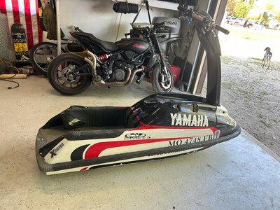

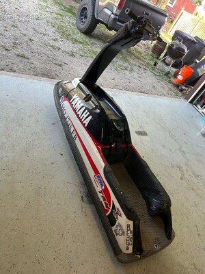

Picked this up last night. 760, b-pipe, footholds, trim system, bored nozzle etc. Has an X-h2o sticker so figured it might be one of you guys.
Won't run right in the water apparently, I've not had it out myself so we'll see. Has an MSD Enhancer, will this work on a 760?

Start with the basics , do a compression test , change the spark plugs and go through the carbs before trying to chase any electrical-ignition gremlins down.

MSD ignition was grounded incorrectly. Holeshot switch was grounded permenantly. Fixed I think. We'll see at the lake tomorrow.

Found out it's actually a 701. 61x cylinders on 760 cases. Common mod? Or just something made out of parts laying around
Fairly common people using 760 cases that way if later they want to move up to 760 cylinders it's a bolt on process.
I was actually going to do that on my ski till I found a very well priced dual 38 intake manifold and carbs for a 61x motor.
