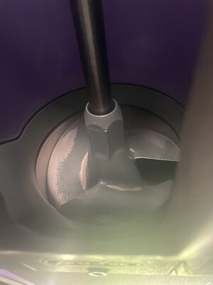

Looks like oem stock aluminum to me:
I would save the pipe for something with a 144 pump. Definitely find a stainless impeller, none will load a piped 701 at low speeds. The FX1 has a 440 pump.

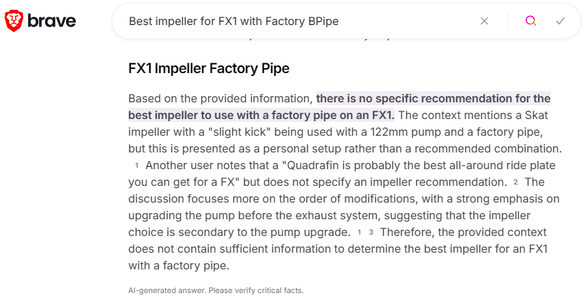

ADD , ADHD , DAMNIFIKNOW , I need to know right now and don't know how to do a Google search ?
