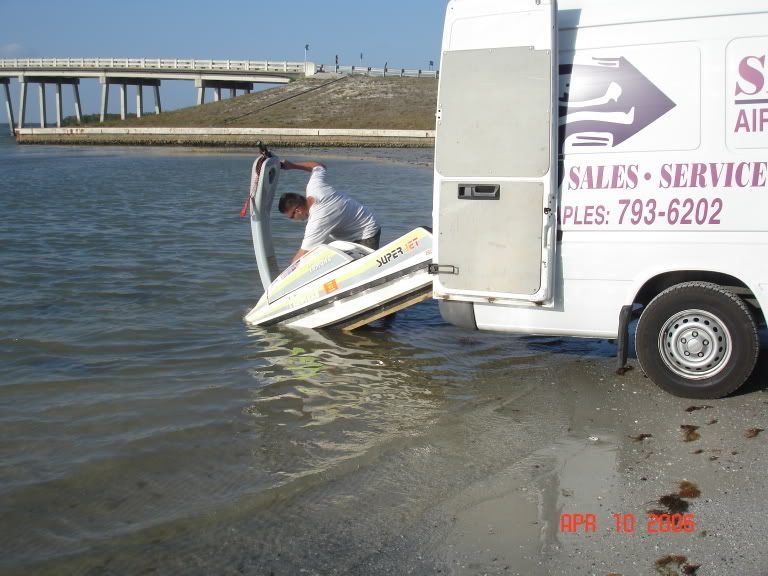

Boris
The Good Old Days
Here's what I did.
Just got some scrap PT wood and leftover carpet.
I could get the ski in and out of the van by myself without getting the wheels wet.
Another bonus was that I had the ski in the van all week and when ever I came upon some nice water I would ride.:Banane01:
