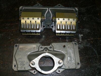

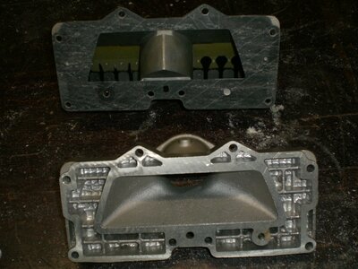

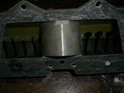

This is what I have:
(its also for sale)
SUPERTUNE
Race Gas Rules
Clearwater Fl.
That's just a std OEM yamaha type, even tho Wetjet used them. The Wetjet one with stuffers is a 1 piece manifold, not a 2 piece oem type one shown in pic...
