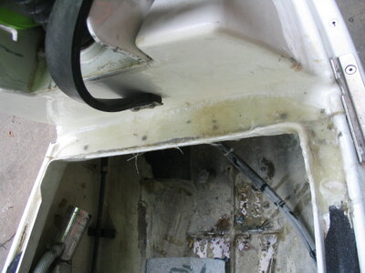

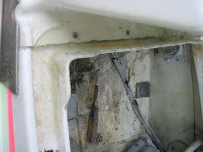

alright... I got the seal off and gave it a look see. I think I can fix it quick fast and in a hurry. My suspicions er correct. they used, something, to bond it. it's not even glassed. The gap is natural. the 2 peices dont fit together tight so what ever the bonding agent was...it failed.
so, I'm thinking some kinda filler then glass it over top and bottom. I dont think clamping it together and trying to glass it closed is really the answer here. My thought is stress could cause it to just come apart again, or just break in adifferent area as it tries to return to it's natural shape.
suggestions?

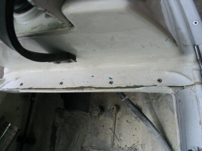

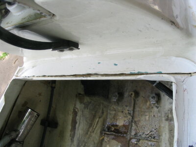

The nose is repaired.
I used SS rivets to pull the sections together then epoxied the seam. then I aplied several layers of 5oz woven cloth to the seam and surrounding areas. I also ripped out my old Jet trim mat while waiting on cureing. the new turf and pad is cut and the tray is prepped. I nixed the hold idea for the time being in favor of lifters. I'm not ready for holds yet.
I may shoot it tomorrow just for grins. it wont be the prettiest bell at the ball. but it'll get the job done.
