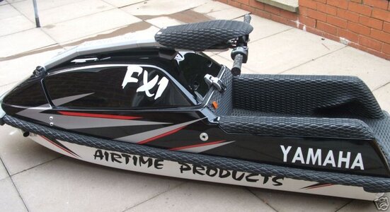

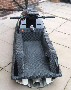

The Queensford FX-1 now stays with me.
The motor ROCKS, But the hull i think is finding it hard to cope with the extra power.
Then again it could be me. I`m finding the FX very unstable.
Were they known for being twitchy.
I have only been out on it 3 times, And i am swimming more than normal.

I think the fact that it is less stable is even better for freeride, or at least freestyle. That's a nice looking ski. Is the fiberglass work holding up under the stresses of the motor and the landings? How about the pole area? Can you post some pics of the nose and pole area of that (maybe start another thread, or PM me). Thanks.
So far so good, No problems.
Maybe unstable is not the right word. I find the ski tracks every wave or wake it passes over, It wants to go one way and i want to go another.
Having never been on an FX before, Just wanted to know if this was the way of the FX or a result of the larger pump and plate.
I will send you some close ups of the ski when i figure out how to do it.
