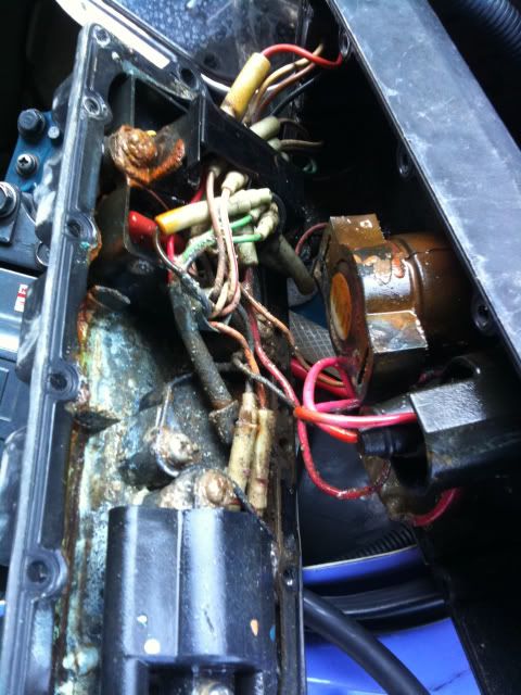

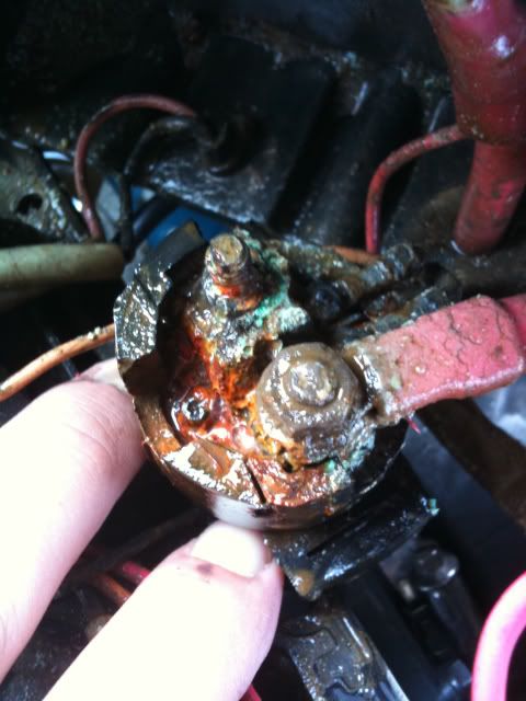

I was out riding pretty hard on Sunday when I rolled my WB1 over. I've owned this ski for a little over a year. Oddly, the ski wouldn't start back up again. When I hit the start switch, I could only hear the little click. I pulled it back into the dock and first tested the battery. It was fine. Then I disconnected the start/stop switch and tried to bypass it. Still nothing. This morning I thought I would pull out the e-box and see if I could short the relay to see if it would crank over.

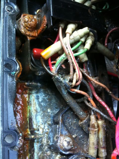

As I undid the last few screws, thick brown water started pouring out of the box. The good news? I found my problem. The bad news?
Same exact thing happened to my SJ. I replaced the relay, battery cables, ebox seal, and a few screws and its as good as new.
Also: Use dielectric grease on everything.
