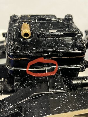

Just pressure tested both carbs, honestly seems like the needle and seat are sealing. However, both carbs seem to be leaking in the same spot at the base of the fuel pump block. Any ideas why they would be leaking there with new genuine gaskets just installed?IMG_5557.jpeg

Are all of the gaskets in there, Yamahas have a extra gasket that other machines with SBN44'S don't have . I usually sand the surfaces on the fuel pump with 400 grit and WD40 to make sure they are flat ,LMK if any of this helps , what is the popoff on the carbs coming out at ?

Taking them back apart and putting them back together seemed to fix that leak but i still cant get them to hold all the way to popoff pressure. Ive gotten them up to about 45 psi without it popping off but then it tends to bleed off. any ideas?

Turns out i had the slightly bigger diaphragms in the carbs causing them to not seal against the weirdly shaped o ring on the pump side. The rear carb is popping off at 35psi and the front carb is popping off at 41psi.
