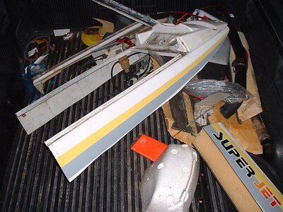

Some sweet stuff waiting for my hull to be done and my motor I had in my square, I might be selling the oem 44's and manifold off it and going to mikuni 44's or 46's with full spec intake. I'm re-painting the head pipe and chamber cause they look like chit. I have to get a couple welds beefed up on the chamber to prevent a mid-summer machine shop trip. I'm still waiting on a hood latch, my prop, grate, and some other misc stuff too.

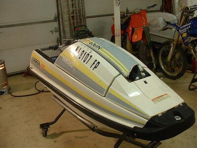

OK, just got done doin some work tonight. So far the bracket area is re-enforced, which I did last week. Today I got done the nose, laid carbon on the firewall, and put a layer of glass in the bottom with a layer of carbon over top. All I have left to do is the sides which I may finish tommorow night.
Still on the to do list after re-enforcement is done is to put in all the waterlines, nstall the scupper, new exhaust tube:sneaky:, footholds, foam it, then its ready for paint, then turf it and assemble it. Definetly done before may.
First pic is the nose and bracket area, the second is the bottom of the hull and the firewall.

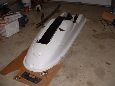

Its been a while, but school and work are done so I have been on this thing since saturday night. I got done all the re-enforcements about a month or two ago. Since saturday night, I put everything in the back end-scupper,exhaust, waterlines etc.; water tested it, put the footholds in it, foamed it, put the handlepole assembly on it, painted my motor black, put the steering system on , throttle cable,ss switch, steering cable, front exhaust, motor mounts and strap fittings. Tommorow I plan on sealing up the tray and while thats setting up I'll do the hood seal, hood hooks, hood latch, start bolting in my motor and by the time I'm all done that I should be able to start turfing the tray and rails. I'm planning on hitting the water by friday, I don't have work or anything to worry about this week so it should be done. I just set the motor in the hull in the pictures to see how it looked in there. Everything is all dusty so I will post up better pics when everything is together and cleaned up.
