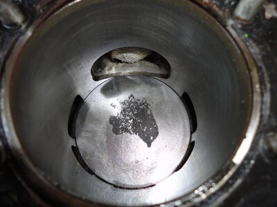

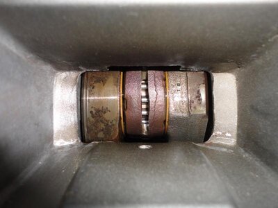

I have a motor I'll sell you. Looks beautiful on the inside. Spins nicely, 140/140, no noises with the head on. Starts right up and makes power. You buy my engine right?
Except it died on me the last time I rode it. With the head off there is a slight noise when you spin it but nothing you'd think much about. When it runs now, it vibrates like there is a family of pissed off badgers stuck inside of it.
I am waiting for the flywheel tool so I haven't split the cases yet, but I can pretty much say with certainty I lost a crank bearing. The motor looks mint because the crank bearings haven't grenaded through the motor yet, but if I'm right, they will soon. REMEMBER.. you can see the crank rod bearings, you CAN NOT see the crank bearings.
