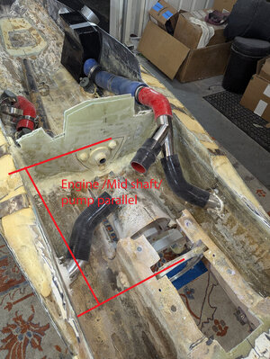

Love this chit. Keep em comingMid shaft smooth through rigged jigs. Center lines within tolerances. View attachment 449813View attachment 449814
