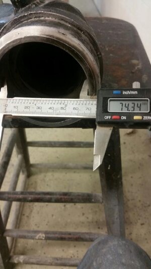

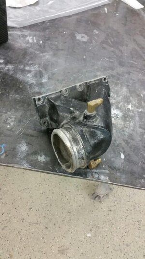

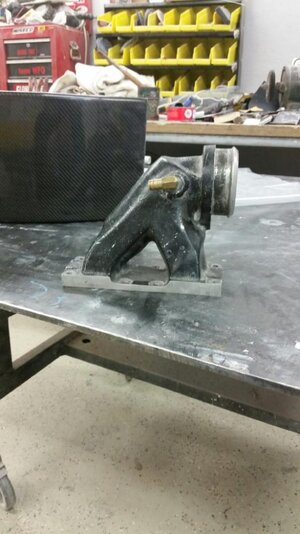

Here, is pics of the Type 8 Manifold and its measurements, dimensions and flange sizes.

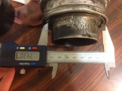

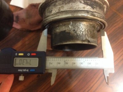

Here, is pics of the PFP Exhaust Chamber and its measurements, dimensions and flange sizes. The Type 8 manifold will fit the PFP Chamber. I have proved some people wrong!!!! :):p

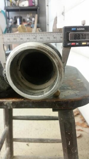

This measurement is how much clearance the Type 8 Mani has against the PFP Chamber. Pretty darn good! Mates up with O-Ring perfectly and both the manifold and chamber have coupler (outer diameters) of about 88mm. :D
