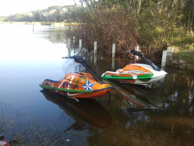

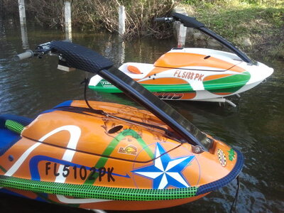

Sj762 tested his new build today with a Chuckie 760 motor with lowered port timing, mag pump and the Freak rips !
10/16 hooker, bored b-pipe, enhancer, 46's, R&D reed n case stuffers, epoxied mani and cases, lighten fw and more....feels like a flatwater flip waiting to happen...
Miy hull was bought from Matt_E and has a 735 ported by XS, 44's and above stuff minus mag....

very nice, im just about finished in building a very similar 760 motor for our glass freak, what kind of compression is that one running? pump gas?
custom pump gas domes for the lower port timing...around 200.

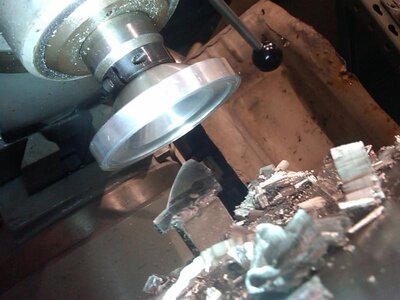

i just made some tooling this afternoon to cut the domes for the decked cyl base, worked out well. i went 2mm on port timing.

Pretty cool rig there, who decked your cylinder base ?
