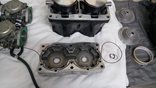

The 5mm plate compensates for the different distance between pin and top of piston. Nothing to do with stroke.
Still unknown what brand/type of cylinder and cylinder head are used. Cannot find anything on the internet which have the same looks as my head. Maybe one still recognizes it?
I bought a freestyle ski with the goal to backflip it. I know that a stroker engine gives more torque and thus more low-end required for flipping. I think that with this setup you can still flip it, but it will be much much harder.
Unfortunately, this setup is not the 1000CC (with stroker engine) which the previous owner told me.
The price I paid was based on the 1000CC setup. What would be the costs to still transform it to a close to 1000cc engine? I know that 10mm stroke requires a lot of adjusting to make room for the crankshaft. It will even need a stiffening plate at the bottom. But maybe someone can give me an estimation of the costs. Or is it better to stay with 8mm stroker to get the most bang for the buck and get the best performance without huge expenses on maintenance?
Next to this, maintenance. With the standard stroke there is less maintanance compared to a 10mm stroker engine. But how big is the difference? Maybe someone can tell something about difference in hours for top-end and bottom end?

You will also need a new cylinder as the port timing will be all to heck with that extra 10mm of stroke

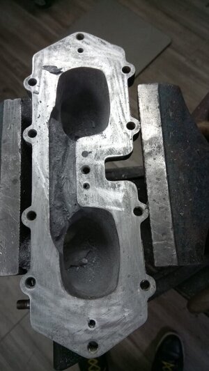

I would be very curious to see what is going on inside that cylinder. It looks to me they added material somehow for extra transfer port volume....unless it is some kind of aftermarket cylinder.

That is a very old motor . Gonna say it was once a race motor, the pipe dates back to early 90's with the "Mariner Factory Pipe". I think Mariner went out around 92 or so. Back in the early 90's there was a dozen different heads available. It has similar shape to the ADA's but it is not one of theirs unless it is a very very early one.....
It does appear material was added there which would make sense as the transfer port area gets really small with that big of a bore.

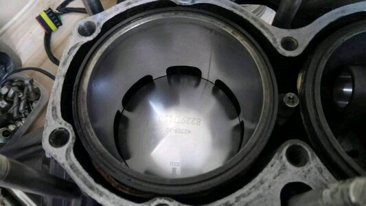

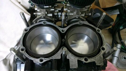

I received more information and pictures from the previous owner. Did not ask him about the stroker story yet. I need to find out the details of this engine first.
He says that it is a 6mm stroker for sure and with 90.5mm bore the total displacement is 1012cc. This does not match according to the Stroke/bore table.
See the pictures. The top looks like a X64 760 cylinder which is reinforced from the outside. But the bottom of the cylinder looks totally different to me.
Maybe you can easily see what is done here.

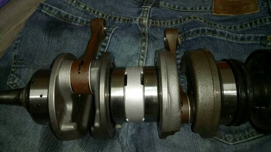

Looks like a stock crank to me.
its definitely a 90.5 mm piston in there for a cr500 wossner made it.
THey have been filling on the bake of the transfers a lot for some reason on the out side.
No head gasket it is an o-ring head, you can see it in the pics

Stock stroker for now.
If i want to upgrade in future, what stroker crank can be used with this oem cylinder?
4mm stroke crank is the biggest drop in for 62T cases?
What would be required to get in a 6mm stroker? According to the blowsion big sleeve it can work from stock stroke to 6mil strokers.

You need to know the port timing before you can simply put in a stroker crank. It changes the timing a huge amount.
This head is one of his own production. He let them make in czechia back then, if i remenber correctly.
I dont know exactly, but there is a chance that the head accepts ada o-rings (bigbore)... you have to take it apart and messure...
He did innovativ tunig back then, thinking out of the box (see his transfer port mod on the cylinder) to produce inexpensive power for the people.
I believe the base plate is to compensate the port timing of the 62T or 64X cylinder, so he could port the cylinder to his likings. i'd like to see the sleeves!
His engines riped your arms of if tuned corectly! I´m sure the boat is flippable with this light hull... even without a stroker.
