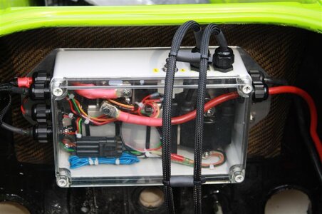

I made a waterbox box out of polycarbonate last year before Daytona. Here is a thread I started regarding it. Mine was a little big but it worked great. There are other ideas in this thread that are better too. http://www.x-h2o.com/threads/66729-Sealed-total-loss-box
