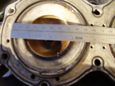

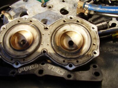

Yeah, i shouldda known better than to get to close to the shallow spots and suck up all that sand. She got hot from sand blockage. Blew the front cylinder o-ring. (WHO'S GOTTEM??) I'll have pics later.

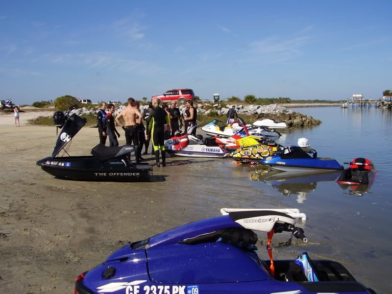

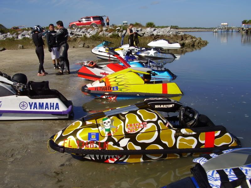

Meanwhile, enjoy these from Sunday. Good times with by good buds. Florida East Coast fun ride before the Daytona Motosurf.

It's a COOL HEAD by Pro Design.
I checked out mcmaster and i think the #153 is the one.
Width=3/32nd's
I dont know where i'm gonna get the one around the base.
Width=3/32nd's
I used to run a Greater head which (if my memory is correct) was the same design as the Pro Design heads. It took UMI domes if that helps. I got the O rings from Kevin Collins @ legdrag/Wamiltons.

Got the #153 viton o-ring comming. Might get the stainless bolts that i broke from there too, if i dont find them localy in orlando. I need M8 x 1.25 x 70mm
I also have the pump apart to tap the vain housing for true duel cooling. (damn coquina shells)
