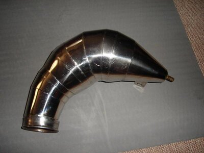

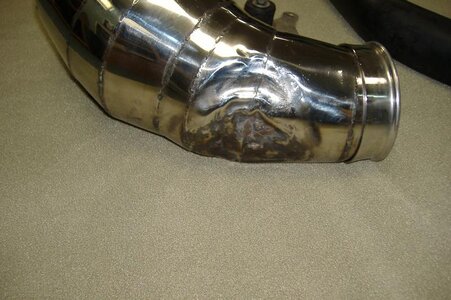

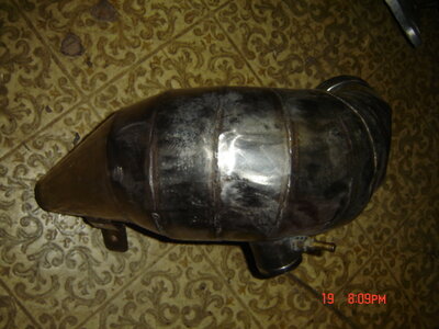

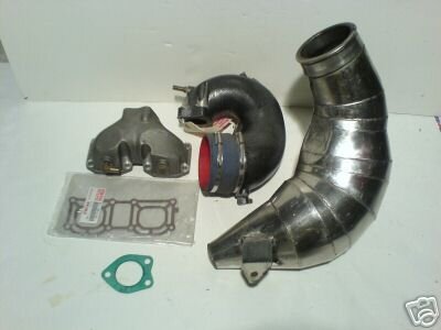

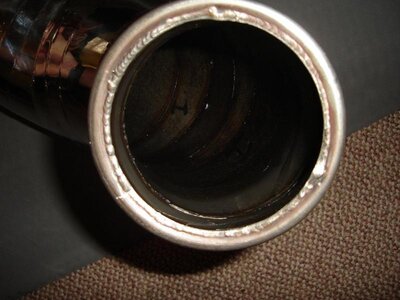

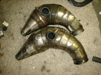

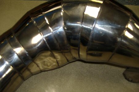

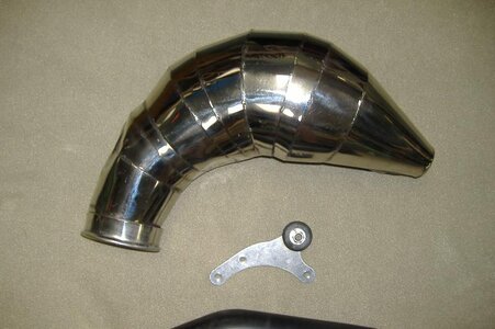

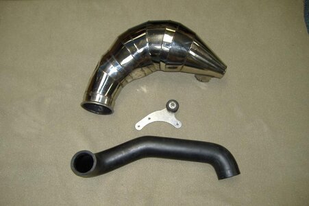

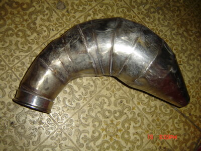

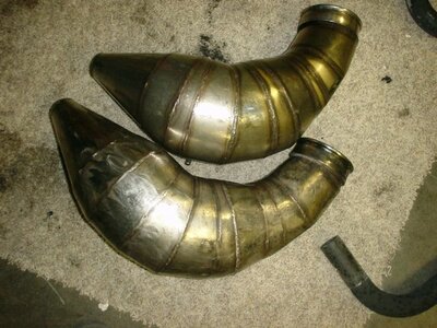

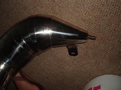

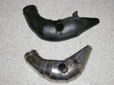

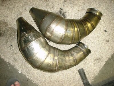

Just posting info gathered from an old thread to speak to the three different chambers.
Original thread, http://www.x-h2o.com/threads/28540&highlight=tnt&page=6
Not sure if anyone noticed but there are three tnt pipes in this thread and all three are different model chambers.
The one for sale is a limited chamber, you can see the bracket was moved to the bottom, and the grinding marks on top from the removal of the old bracket.
The coated pipe is a stroker chamber, and the polished pipe is the superstock chamber first addition.
The limited pipe has more bottom but will sign off hard at 6600rpm.
good freeride pipe for somone to wants hard hit and doesnt care about RPM, but wont make a good race pipe.
There was only a few limited pipes made.
First 3 pics are the Limited Chamber,
4th pic is a Stroker Chamber,
5th pic is a SuperStock Chamber First Edition.
Last 5 pics are unidentified at this point.
Feel free to correct me on any of this BTW.

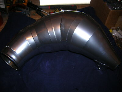

Couple more pics for comparisons and identification.
