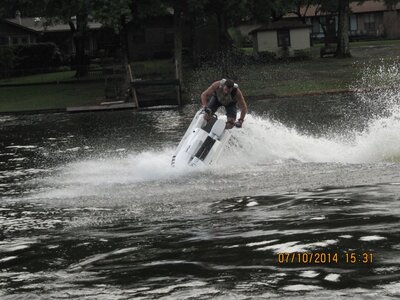

I just saw the pic man, it looks sick in the water. Gotta get some footage up of you ridin it. Just a heads up you needa move your registration up to the nose, I got a warning from FWC for putting mine on the back like that. By the way how'd you end up registering yours, homebuilt or sj hull tag and title?

I'm loving it! Everytime I ride it, it gets better. I was outta state for 6 weeks (couldn't take the ski :( ) got back on it when I got home and it is just so natural. I'm still not that skilled so mostly I'm sliding 180-270s, doing nose stabs and 180 broncos. Haven't had the time to get out to the surf recently. Missed the hurricane waves here by one day! bummer. But I gotta say I really like this hull.
I am particularly happy with the predictability of sliding vs cornering. You can totally sling this thing around a turn sliding like flat track racing on a motorcycle. Feather the throttle a little to keep moving then bang the bars over against the stop again with a little blip of throttle and it is like drifting a corner in the car. Shooting a nice rooster tail most of the way. Not much of a trick but pretty fun. If you want to carve/track a turn, just lean it over a little. The only draw back on this thing is because its short, its not much fun to cruise around the lake on, particularly if it is rough. but that is true for any short hull I think. I'm more than happy to give that length up to get the faster and more dramatic rotation speeds. I have gone from looking like a complete idiot on a stock length ski to being able to pull some decent 180 nose stabs and my skill level hasn't increased. Its all because of the hull. I have almost the same motor set up in my SJ and now it thing feels like a tank when I ride it. If I had an extra 4k laying around, I'd buy another Aquabot and gut the SJ to build it.
Other than not having a front foothold on it, there really isn't anything from Tigercraft that I wish it had. There are a couple of things I still need to do like getting trim on it (for flatwater, don't need it for the surf). I really want to paint it but don't want to take it out of the water that long! One note about the front foothold, as I get better at handling this thing, I'm riding more and more in the back footholds (not surf stance) and not thinking about the front foothold so much.
I've landed sideways, flat a couple times off a pretty good jump (big boat wake) and it is holding strong. I know they would have popped my hood on the ol' SJ. Haven't had a bad landing from a high surf jump yet but this is a tough hull and I really like the hood design. Friend of mine is talking with Tigercraft about getting one and they now have their own hood hook design that fits this hood. I tried modding a stocker, tried the CF and the ADA hooks and they just don't fit well on this hood because it is so low/short. I've been just running a ratchet strap so far and haven't had any issues. The tongue and groove style of hood matching to the hull is pretty slick. It is a tight fit and matches really well. I don't know how TigerCraft can get that many variables to line up so well from two seperate molds but I like it.
