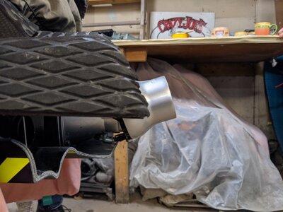

Here is my friends nozzle at full pull with the same system except he has a RRP lever and Thrust steering nozzle.

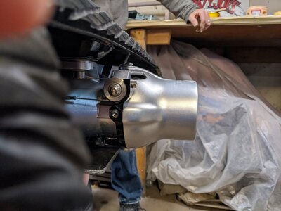

And here is mine at full pull:

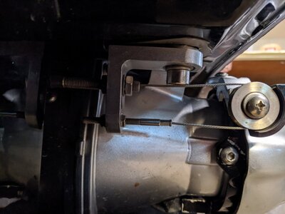

Here is how his is adjusted at the cable end:

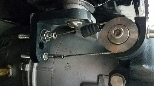

and mine:

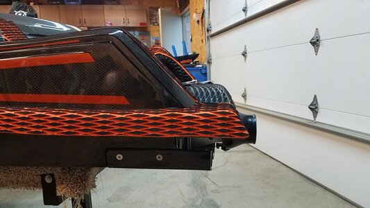

His nozzle at no pull:
