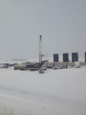

It hit -39 Celsius here today. There shutting service rigs down..... And I'm going riding in 2 days.
