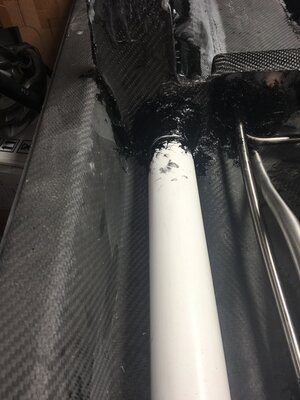

ln the pic below is the exh pipe coming out of the rear of the hull.Leave it long or cut it off? Opinions?

Leave it long, Keeps the exhaust spooge off the hull, minimal hull cleaning required!
