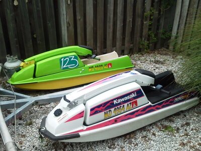

Looking for some help or input. I have 2 Kawasaki 550's both are about the same, they both have reed valve engines,stainless impellers,mariner ride plates,aftermarket bars,and trigger throttle. the difference's are one has is JS hull the other is a SX. 0 deg bar vs 7 deg. top loader intake vs open mariner style.The problem I have is the js out performs the sx by a lot. The js carves up turns and the sx takes a football field to turn. I put a jetlyne impeller and 0 deg bars on the sx over the winter. and it got worse. any ideas? could it be the impeller/nozzle? nozzles move same on both skis. ski has great thrust also.
