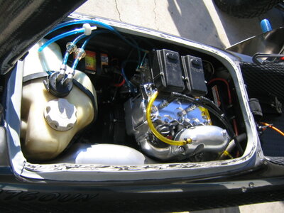

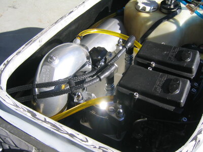

more pics.

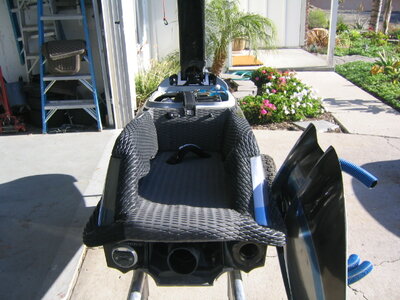

kinda looks like OEM, look near the base, like a bulge there.......
hey Runaway, didn't I sell you a used pole a few years ago??
Yup! Thanks- no its not the same one. This is a -4 stocker wrapped in 3 layers of tubular carbon, vaccum bagged with epoxy resin.

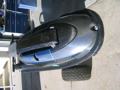

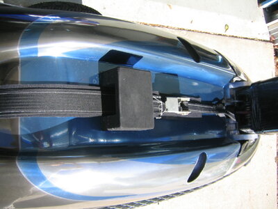

The hood seal is hydro turf and stops the hood from sliding side to side on hard landings in the surf. No hood latch here, just a ratchet strap. I have used this system for a year now with no hood slide/loss issues. No more hood latch and hood straps. Just one ratchet and its on for good. :biggrin:
