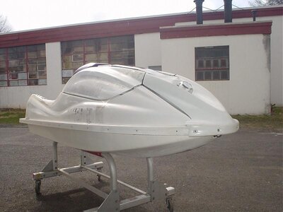

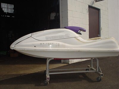

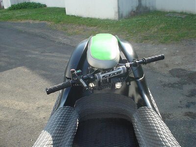

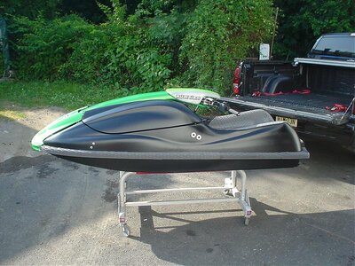

Got to water test it this weekend in the surf for 3 tanks then a tank rec riding. I'm not liking the worx grate, unhooks to much. I'm going to put a skat cut back on.

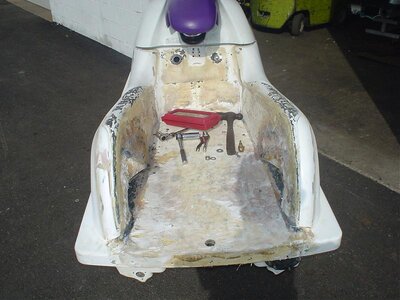

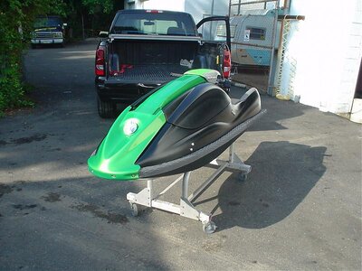

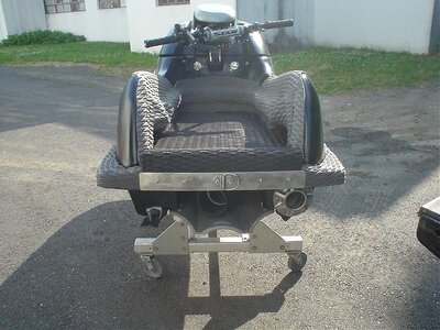

Here's some pics
Tray is done in 2 layers of 8mm than a 4mm later. 1 1/2" kicker, lifters all the way around. Pain in the a$$ to turf. Threw the crap plastic rear plate away and made aluminum plate and stainless tow hook with backer. I towed my boy in this weekend through the inlet and it didn't break. :Banane01:

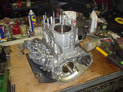

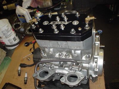

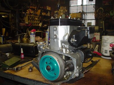

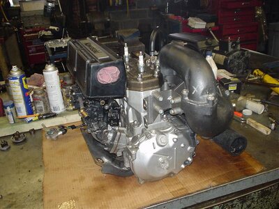

The brap is good, still need to tune in the wet pipe to hit a little farther down low. I had the bottom open a 1/2 turn. middle closed, & top turn & 1/2. I'm going to close the bottom screw and open the middle 1/2 turn and try that.
I'm running stock carbs with chokes and it's perfect. No heistation or loading up. I'm getting 185psi with the TBM head and like the RAD flywheel. It really lets it spin up quick. So far it's a fun surf boat.
