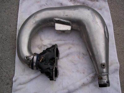

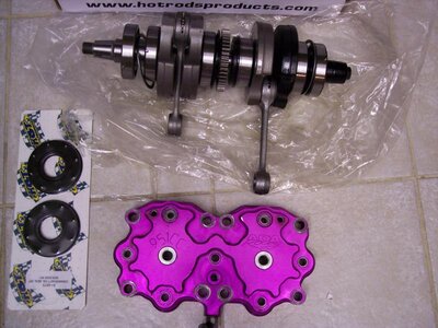

Up-date I have the new crank , ADA billet head , pistons are on the way machinist has the cylinder , now comes the critical part motor mounts and drive line mods and what size pump to run I am leaning towards Peak Powersports set up Rick of Peak has bean doing these builds longer than anyone and seams to be the most knowledgeable at this point that I have talked to and has helped guys like MAC , FARTHING with their set ups he told me what pump related mods need to be done to fit the 144 mag pump and there is a few .
