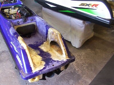

Maybe an aluminum plate stuck to the front and rear of the tray with a couple tapped holes and use bolts with wing nuts or thumb screws welded for quick adjustments? Then again, the plate would be a b!tch if you wanted it removed.

beachjunkey said:
Sorry I have no experience to advise from, I just copied your idea. Hopefully I'm just another two or three weeks from trying it out.
:biggthumpup: looks nice

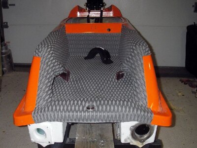

I just installed a front foot hold I picked up from Highroller... I plan to try it out this season. I usually ride with my left foot that far up in the tray anyway, but then have to tuck into the footholds for doing other tricks. I'm hoping to be able to use a combination of the front foothold with my newly extended rear footholds. I hope it works... although I am not to sure how comfortable it will be with this setup... seams like it may be a bit awkward. I may end up putting a rear strap on with the front foothold.
Here is what is looked like before turfing.

IceRocket1286 said:

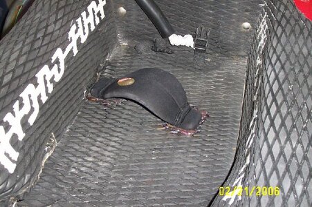

hey look, at least you learned something.....sometimes you HAVE to do that..
why not try one foot in the hold and one in the strap....thats how I ride 100% of the time..
