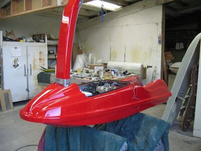

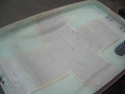

but, do i spy 2" pvc drainage fittings and pipe for an exhaust tube???:scared:
yep, it's lighter and I ran it in a previous hull before so I know it works. He's done alot of things to save weight to offset the 66e motor. Did you notice no scuppers or handholds either?
ive seen the heat from exhaust heat up and deform pvc exhausts before. cpvc or a carbon fiber tube mightve been a wiser choice of materials.
why no scuppers or handholds?
It'll be fine, don't forget some waterboxs are made out of the same stuff. plus a straight tube wont work because i need some kind of high point since I'm not running a water box. The water would run backwards through the exhaust opening into my pipe and manifold without running it the way it is.
scuppers sink boats, I'm done with them. A well sealed hood, bilge and factory siphon will get the job done. I'm not planning on sitting on the hood of this one.
