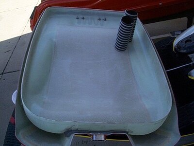

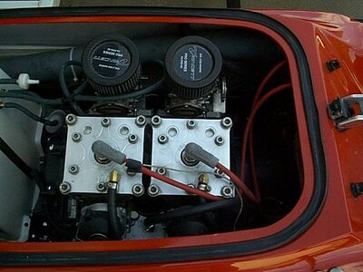

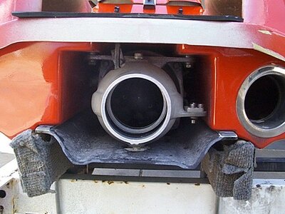

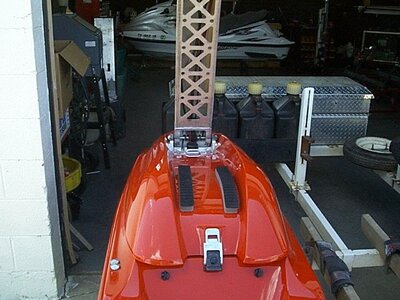

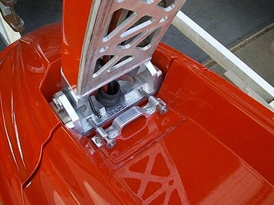

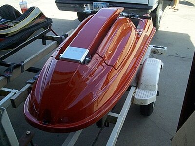

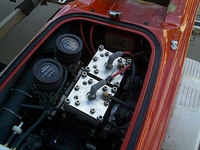

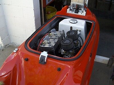

Here is my latest build, its a Waterdawg Kustomz REV hull. Its the one I had hoped to get to the lanier buildoff but was unable due to my work schedule. It's not done yet but I have ridden it and it hits like nothing I've ever ridden. 950cc, 148 mag pump, Dual 46 full specs, msd tl. The new hull is pre preg, and it weighs (bare) under 70lbs with hood. It's a newly designed top deck and hood with new hood latch design in the front of the hood, new pole design and new pipe design.

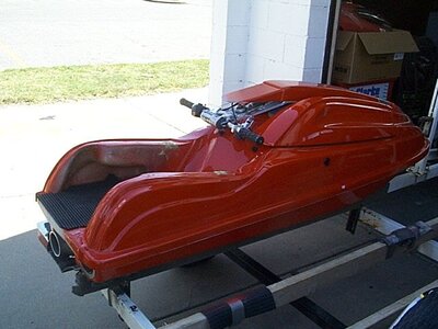

some more, I'll turf it this week and it should look quite a bit better

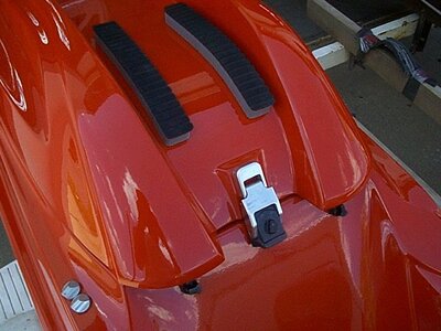

look at the front latch it pins the front of the hood instead of using hood hooks. you can drop the hood straight down on the hood instead of pivoting it on the front hooks and hood seal.

Nice! Jeff does some killer work. How does it feel having that power in a 70lb hull?

Thats what Jeff was saying. He said it is the only ski that has just pulled so hard he just could not hold onto it. That is awesome. Jeff is a very inovative guy and that motor is going to start dominating freestyle.

Yeah, Jeff has a couple of different design bottoms you can choose to put on you hull. That motor is so bad ass! :headbang: The handle pole is rockin as well as the hood latch set up. No side to side movement in that sucka.
