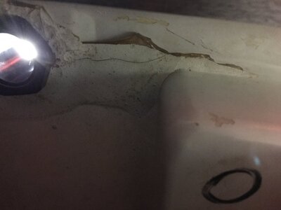

Hello my superjet has a crack running from the rear eye a couple inches. What is the bast way to fix this. The rear has also been deformed if that makes a difference. Any help would be great! Thanks
Start by removing the gelcoat and seeing what it looks like under. It looks like a lot of that may be peeling gelcoat but it's hard to tell from that picture.

I'm pretty sure it's a crack. I will try to get a better picture. If it is a crack what's the best way to fix it?
If the crack is all the way through, then you can drill the ends to it doesn't extend further and then reinforce it with epoxy and glass.
If it's not all the way through, you can just grind the damage out then reinforce.
Fill any small voids with epoxy mixed with a filler so your reinforcement layers don't have air under them.
