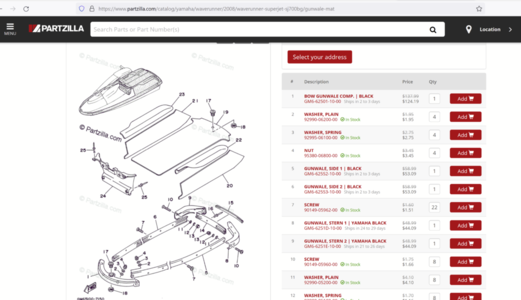

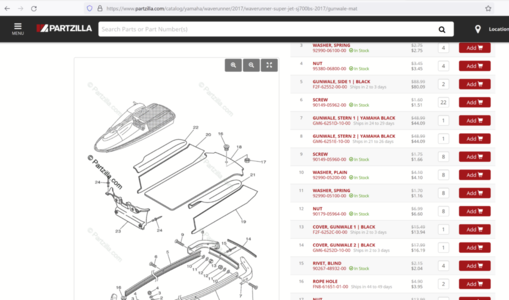

Thanks. Yea, I looked on ebay. Most of listings are whole box. I wonder if previous owner had an aftermarket part he wanted to keep. I only ride flat water, and not overly aggressive yet. Thanks for part number!

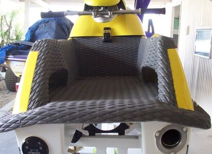

Actually it kinda stretches it out when you heat and form. When I cut the material I leave some extra and then trim afterwards. Yes you will have a small seam on the back rail cap corner. Just cut and butt and glue them together.
Wow that looks nice! Thanks for replying. Someone sent me a photo of a cutout shape (dart) on mat before installation. Guess im trying too hard for perfection as I am obsessed with this new to me ski
