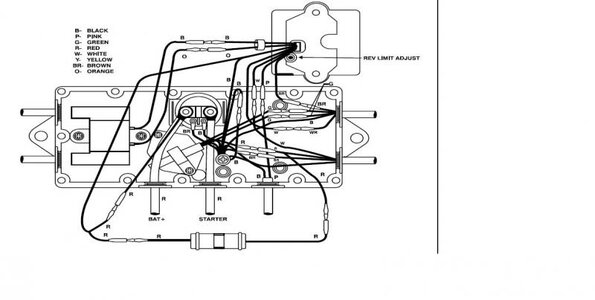

ND
Hey guys just talked to MSD and they sent me a new diagram because there's sucks to follow any lines. I am thinking that it is something with one of the connections or ground but I will post this one to help anyone. Life would have been ten times easier if they would update their website.

Two things come to mind...
1st:
MSD uses 2 white wires with 2 different ends. '96 up Superjet 62T stators will use a female to female jumper (comes with the ignition in the box) to connect to the stator white/red male and the MSD has a white male.
The '90-'95 6M6 & 61X stator will NOT use the jumper adapter lead and plugs directly to the stator lead.
The 2nd white wire from the MSD will plug directly to the white lead for the start/stop harness lead that goes through e box grommet to the 2 pin start/stop plug lead.
Make sure this is wired correctly.
2nd:
MSD Enhancers have a split red 3 wire joint and is heat shrinked, this joint is a common problem to not be good, so when having spark troubles always re-solder this joint to be sure this connection is 100%.
Then if this doesn't fix it, try a new MSD or stock CDI.
Of course as stated in a previous posts an inspection of wiring, stator and coil should be done.
