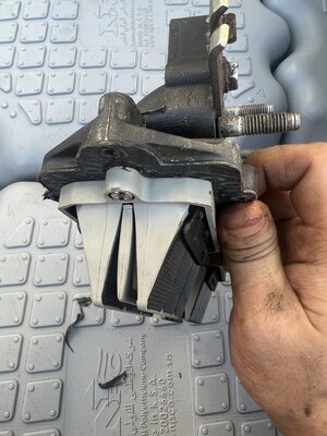

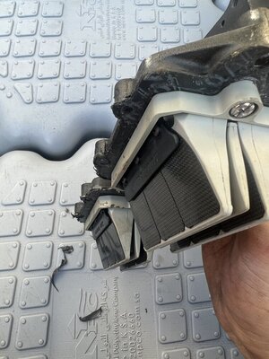

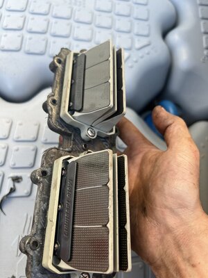

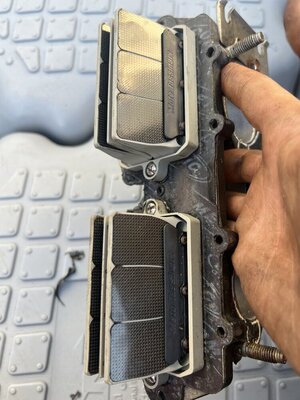

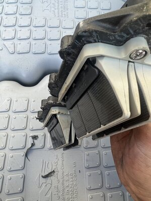

Hello, this is my first time posting on this forum. I have a superjet 2015 with a b pipe on it. I took it to the water and everything was fine then all of a sudden I had no power the ski starts and idles like normal but once its in the water I can barely get enough speed to stand up, when I go above quarter throttle I dont get anything all the power is gone.
I tried replacing the CDI with a used one I had laying around that didn’t help. I checked the pressure its was 150 on the back and 148 on the front. I also replaced the carb with a used one thats working and still nothing. Replace the spark plugs and checked the coils using a coil tester everything seems to be working. I’m really stuck on this issue I’ve been on it for a few weeks but im not sure what is the problem has anyone experienced this problem before?
