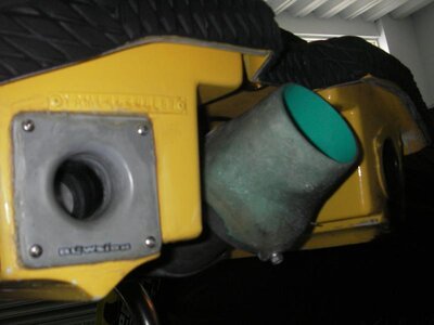

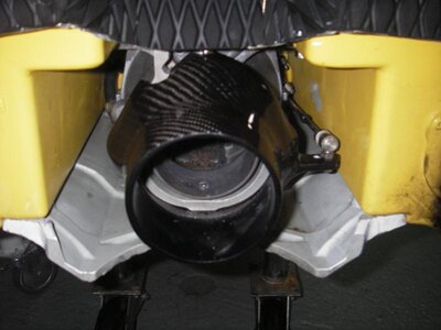

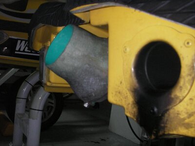

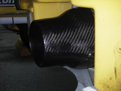

Superjet Freestyle trim system
I have develop this trim can easily modify your OEM pump to trim up here is the link How to modify an OEM nozzle and install into a freestyle trim system http://tw.myblog.yahoo.com/gdjetski/
I'm still working on the English installation guide if you have any question feel free to ask or comments.

Very nice carbon nozzle. I just might have to give that a shot.

I would imagine if you move the mounting holes more toward the end of the reduction nozzle you may get some more throw.
That trim ring and nozzle almost looks like a Pro-Tec setup.
How much just for the carbon fiber steering nozzle?
Yes you right the mounting holes to the end of the redution nozzle is 3 cm if you mount it at 2 cm the nozzle will trim more higher but I feel 3 cm is good enough.
The carbon fiber nozzle only is $130 plus shipping.
