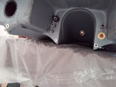

I have a onewaywalve from enginebay to tray. When exhausttube in tray go hot the tray is pressured. When it goes colder it suck air from enginebay in . And i have stainless inserts in with screw to drain the tray if needed .

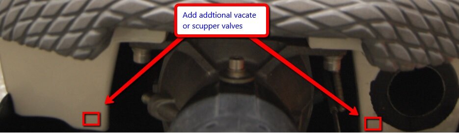

I had same thing happen to my ski and it caused some leaks. Installed a few vacate valves, one bulkhead and 1 for the tray and all seems good.

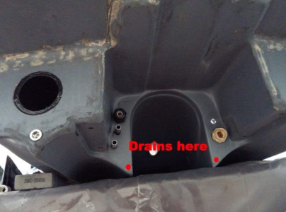

My center chambers have drains on each side of the pump but those have been bone dry since I bypassed one of my leaking water lines... It's only a matter of time until the second cooling line starts leaking.
