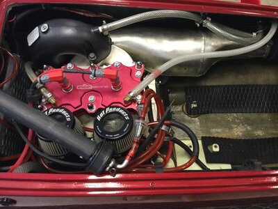

Going to replace my starter In my FX/1 a few questions before I start does the starter have a gasket that I need to buy and the Ski has a B-Pipe so things are tight so how would you go about this 35B48975-AC9F-4A6B-8D2F-7AD83B6F0FCF.jpeg

Can be done without removing the pipe but is super easy if you take off the head pipe (black part). Just 3 bolts and a hose clamp and its out of the way. May need a new gasket though it the current one is very old.
Stockton
I’ll add, anti-seize to bolts and a Circular silver dollar ish sized bead of silicon @ the front of the stater case to act as a secondary seal at nose of starter and engine case...
Btw You may need to pry evenly @ nose of starter to get it out of the engine case
Ok I got the starter out I took the head pipe off moved the pipe forward and now I am putting the starter back I noticed that the old one had sealant on it what are you using is that sealant factory
Thanks
Michigan
I think most people that use sealant on the starter use 1211 liquid gasket. I just put a heavy amount of waterproof grease around the rubber o-rings. I ride freshwater only though, I'd probably use sealant if I were to ride in saltwater.
Michigan
How permanent is that stuff? Looks like it's similar properties to the 1211. The bolts hold everything in place so you don't need anything that has adhesive power, just filling in the gaps between the 2 cases. Don't put any on the shaft part with the o-rings. Just a bead around the starter case that makes contact with the flat part of the engine case.
