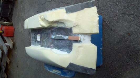

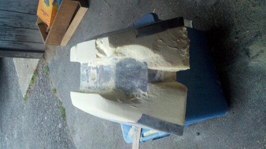

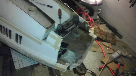

I bought a 1995 701 late last year, and found a crack in the foot tray, at the same time I could tell that the ass end of the ski would feel heavy after riding and i could hear water sloshing around if i rocked it side to side.
I glassed the floor and replaced the matt, seemed like all the water was out, but now concerned that i should have cut out the floor completely and removed the old foam, I drilled two 1/4" holes at the rear of the hull and no water came out, I plugged with removable screws.
any Ideas, like drilling small hols and filling with great stuff, I think water may transfers from the buldge to the foot tray.

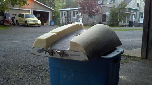

I have no idea what you are doing with that hood? fill me in please looks like a hell of a project.
Also shopping for a pipe.
