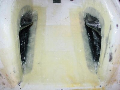

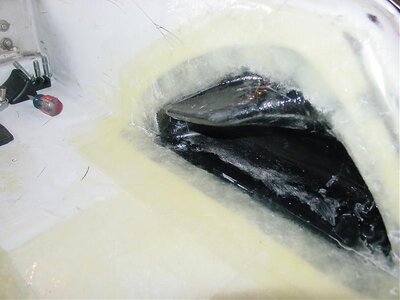

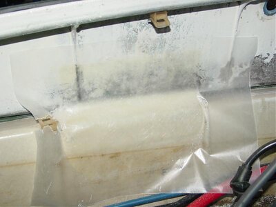

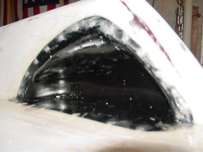

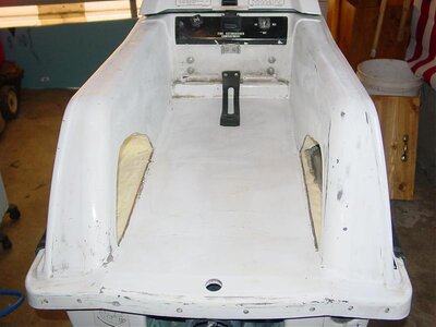

footholds look good, but what kind of glass did you use?
And why are you only doing that very small section of the bondline?
If your gonna reinforce the sides, then fill the entire bondline with epoxy and filler (404 works fine, or wood flour), then lay preferably matback 1208 or 1708 depending on what strengthy you want, over the top of all that, going from the top to bottom. The strongest glass is biax, the weakest is mat. Although mat adheses the best, so matback is nearly the best of both worlds.

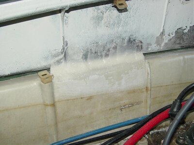

ALSO, on the top half of the hull (in the engine compartment), you really gotta grind all the OEM white stuff off, and get down to the black plastic like stuff, otheriwse, it wont adhese as well.
