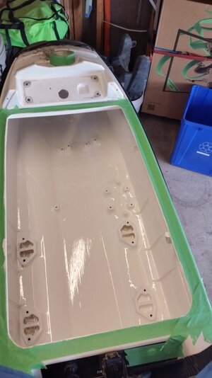

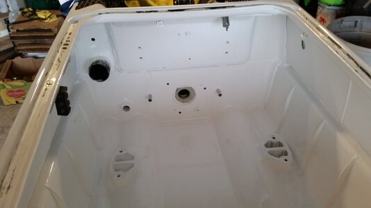

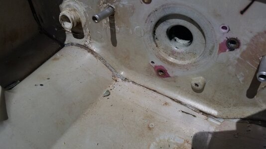

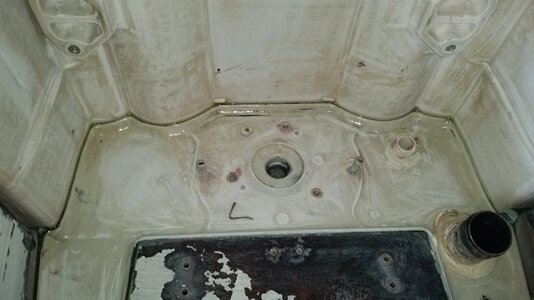

The tray area may be cracked, letting water in. That is a known issue with square noses! they like doing that after lots of use. After repair/ overlay- no more problems. To answer your earlier question about bonding hull parts: very pricey urethane adhesives. Available in dual tubes to use with special guns, similar to bonding automotive panels, or smaller quantity A&B types (mix equal parts) http://www.mcmaster.com/#high-strength-adhesives/=wvvvhc - but as roseand stated, you don't need that- and it is very expensive!
