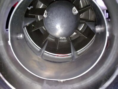

Custom/Hybrid Solas mag pump and reduction nozzle ..is this nozzle too big ?
I have highlighted the size difference in the pic with the red marker...its about 2 mm....do i have the wrong sized nozzle......will it matter ?
Also...should i cut the trim bolts down a bit ?
tks for the help, much appreciated.

Solas pump was designed for solas reduction nozzle. The yamaha 144 nozzles fit like that. Do you have the oring or metal spacer in there? Yes, cut the trim ring bolts down some and remember to red loctite them in.
tks Chris....yes I have the metal spacer installed....yup red locktite on everything.
