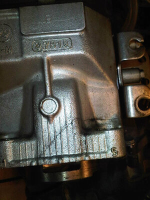

Ìt happen to me too and after further inspection the cylinder was cracked...
so maybe something to look for...
The carbs are in front and hidding it well so it's only when we took it of we could see it really.
