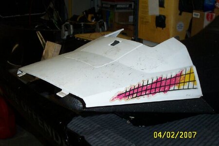

just glass from the back around the door, dont do the whole thing because the piece wont be flexible and may not fit back where it was, I learned the hard way and ground down all the glass on the inside sides so I could manuever it into place and screw it down. Fill in the top side with a filler, sand and paint. Dont use marine tex, just dont.

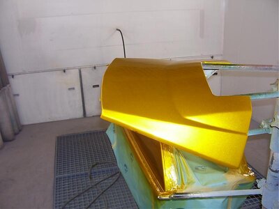

Here is JayB704's nose, looks like it turned out nice. Maybe he would even do one for you for a couple $$.
http://x-h2o.com/attachment.php?attachmentid=20716&d=1171383233
:bigeyes: yeah! thats Perfect im very interested. i wouldnt need it painted by him though ill have it painted by my buddy whos doing all my glass work and painting. I did get A superjet its my Sponsor Ski for the shop i work at my boss bought it with a frozen crank and top end 701 it has a bigassed coffmans pipe and ill be sticking my black jack from my 550 on it after i re jet it its competely stripped like i said its getting completely repainted to our shop color and also reinforced in a few areas too.
