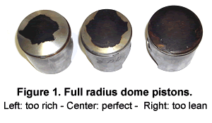

I am getting two different piston wash readings from my sn single 44 61x/61x superjet. The front piston (closest to the gas tank) has some carbon build up with some piston wash, the back piston has very little carbon build (a few small spots) and is mostly washed clean. Running 93 octane @ 40/1 synthetic. What could cause the piston wash to be so different between the two?
