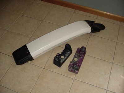

since it looks like your waiting on me i will give you an update. what i got in the pic are both brkts and a completely mint un-molested rn pole never installed. my goal is to make a bolt and go system. basically a sn base rn mount. i also want full extension without grinding on the pole. the pivot will more then likely be a little higher then the sn's for this to happen, but not much. i have most of the measurements needed and hope to have a cad model by next weekend. but this is still a good ways away from having any to sell. i want to thoroughly abuse these before i send them to anyone. hopefully me and turbo626 can test a couple at the chicken bone. after the model is done im still held up some just cause of the trip and some other projects taking all my money.
as soon as i feel confident this is a good strong product i will put a list together and go from there.
thanks
matt

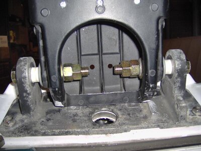

you shouldnt have to raise the bracket much to compensate for not having to grind since (im assuming) the piece youre making will have a thinner base than the cast oem bracket. id think that if you had the pivot holes up the same distance from the mounting surface of the stocker, it may fit without grinding the pole or raising the pivot point.

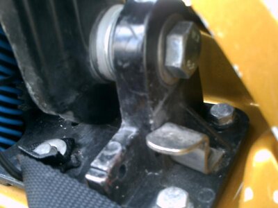

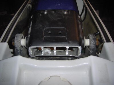

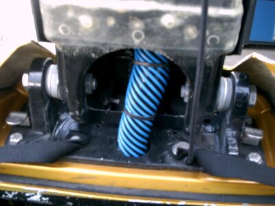

ive done the rn pole on oem sn bracket mod before. here are some pics from a thread i started http://www.x-h2o.com/threads/9516) ... sorry for the low res cell phone cam quality...
attachment.php
attachment.php
