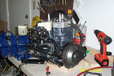

now, since my other motor DID break.....check out the new heart..
she's ready to drop in:
magoo porting with 82 pro-x's
x fly
msd enhance
TLR 48 on riva single mani
riva head 165psi.....no gritel
Bmod

Idok you better get a gridal on that cylinder, your asking for it IMO...
