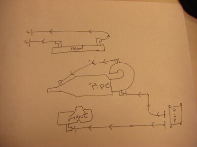

I have a SN, i am pulling out the stock 650, and dropping in a 701, also i will be putting in my solas mag pump this winter too. the motor has a girdled head with dual cooling. I have an aftermarket bilge pump, so i know i can run my second cooling line up through there. But how the heck is the heads/exhaust/pisser's/supplies supposed to be hooked up??? and recomendations on hose size or pisser size??? Clear hose as opposed to black???
