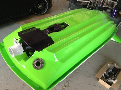

I finished my Carter B rockered and chopped blaster at the begging of last year. I know this ski is not made for lake riding so I am by no means complaining. I was blown away with how fun this ski is to ride and it is better in so many ways. I do find my self riding it decent distances on the lake and it does not cruise very well. It porpoises unless you are way up on the front. Now if this is what it is I'm not worried about it but I am just checking to see if anyone has had any luck with different ride plates or anything to make it a little more friendly.
I cut my ride plate pretty short. It is similar to the one in the picture. I just purchased another stock plate so I am going to do some experimenting with that. I have a stock gas tank and battery relocated to the front.
