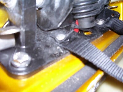

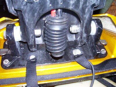

Forgot to add, I did some grinding to the pole first to make it go up farther, then I realized why not grind the bracket and that is all you need to do. Just make the area in between the ears on the bracket flat, and then paint with appliance epoxy black. I tried it on another ski already, and we ground down just enough where it wont go past 90 degrees, but we are still using a limiting rope like everyone should. Also, I cut the hood hooks so they only attatch with one bolt, and did just a bit of bending, they arent the most bullet proof but those with two hood straps in mostly flatwater wont be a problem.

alright i saw the pics it looks great i think i will try that to begin with but then again i will be throwing mine around in the surf a bunch so i might check out that one that pete makes. thank you it was my original idea i will be epoxying the Life out of that area though so im willing to possibly try.
