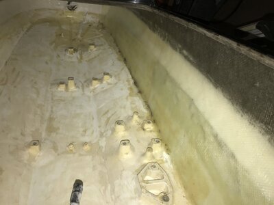

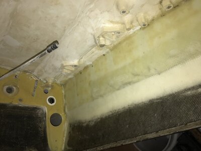

The first piece of 1708 biax went down well. Sure was a resin hog though, took a lot to fully wet it out. Do most you guys only do 1 layer to reinforce? Two seems a bit overkill. Opinions appreciated

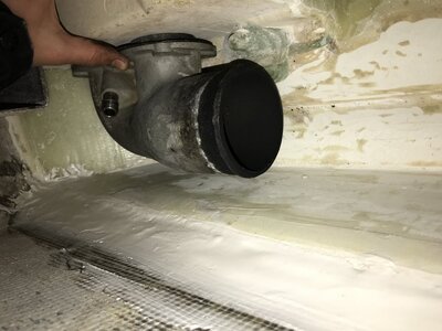

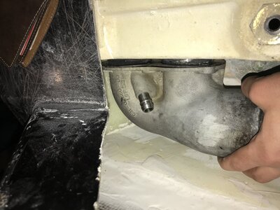

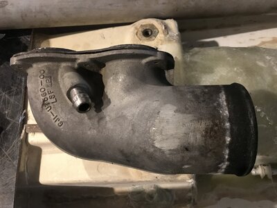

Also I’m tossing the idea around to reuse the pump dump exhaust outlet the the 760 came with. I’m wondering if it’d help dampen some of the exhaust noise and allow a smaller / lighter waterbox to be used. Looks like it’d fit okay, although pump clearance may be a tad tight. Just an idea! Idk if it’d help or hurt anything. It would also make a sweet side exit manifold...
You riding the Great Lakes? The swells get pretty big there right? I know surf skis get more reinforcement and I was under the impression there are surf conditions sometimes there.
Yeah I ride Lake Michigan, and it can get pretty rough. I want to learn barrel rolls and don’t want to end up smashing the ski to pieces, but I also don’t want a tank haha
I see most people laying up 17oz biax on the sides and bottom but I’ve also read about 2 layers of 12 oz. seems a tad excessive but who knows lol I’ll do some more reading I guess

Well, I personally am doing two layers of 1708 on the upper half of the engine bay above the bond line and one everywhere else. I have seen some pics of square noses caving there so I wanted a bit extra.
Got the engine bay all layer up with 1 layer of 1708 (holy resin hog!) stuff sucks to get the bubbles out of because of how much memory the glass has. I also got the 1708 with the random strand backing and that seems to really eat up resin. I think it’s all wet out though, we’ll see as it sets up. I ordered 1208 which will be used to do the nose and some twill for under the handpole area and tray to conform a little better before laying 1708. This hull was so smashed when I got it I’m going to use a little more glass than I’d like to make up for the cracks everywhere. Hope it works out

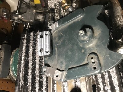

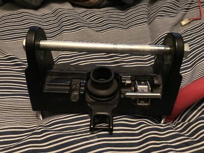

Had some 1-1/8” bars kicking around so I bought some riser blocks off eBay for $12 and threw my turnplate in the mill. Turned out okay

Nice going on the turn plate, it looks good for 15 bucks.

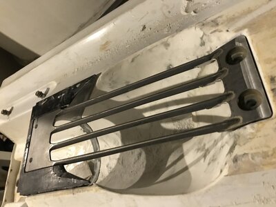

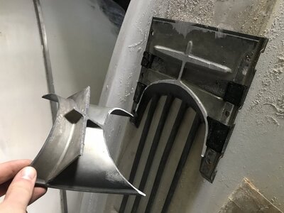

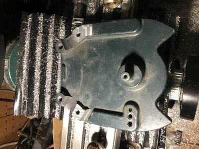

Epic poorness kicked in again and the wave venture intake grate was sacrificed to fit the superjet. Giving the mill a workout. Should work until I get a scoop grate

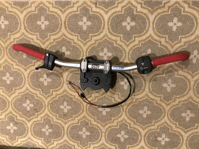

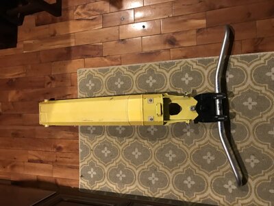

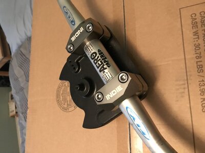

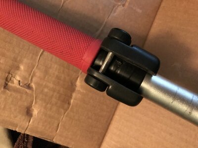

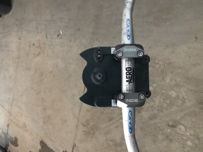

Picked up a UMI pole setup and turned some bushings to accept the stock rn turnplate. I’ll be zipping the ends off the bars (they were off a snowmobile) so I can get the controls actually on the bars. In my mind the hooks looked like a good idea for carving, but mocking them up it looks like they’d really get in the way. Good news is the bars were free so nothing a saw can’t fix

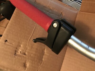

Well unwilling to admit defeat, slapped the oem throttle in the mill to clearance it, and got it around the bend in the bars. eBay $5 grips finished it off. We’ll see how annoying the hooks are before I break out the saw!

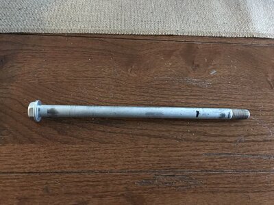

Cheapness kicked in again so instead of buying a rn pole bolt I picked up a Kawasaki Ninja ex500 swingarm bolt off eBay for $5 and a cheapo eBay m14x1.5 die for another $5. Threaded another inch or so on the bolt, cut off the excess and we’re in business! Every used bolt I found was all salty/stripped and everyone wanted $40 for it and that’s stupid. The kawi one is steel not ss FYI so salty areas beware or use anti seize. The kawi nut is a nice addition so you don’t strip out the pole bracket
