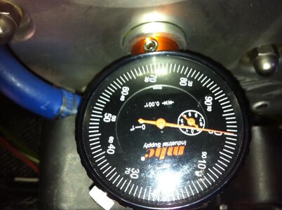

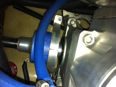

Started the day with doing a TDC (Top Dead Center) check on the front and rear cylinder and putting the marks on my PTO coupler, supplied by Cold Fusion. Thanks for a great product that is easy to add marks to. Set your dial indicator in the spark plug hole and then turn motor clockwise untill it reaches the end of its travel and starts going the opposite direction. Then reset gauge to 0 at that spot and double check to confirm. Once at TDC i added an aluminum piece to use as my needle over the marks on the coupler. Did the same for the rear cylinder also. I used tape around the coupler to check to make sure the crank was phased correctly and that the two TDC's were 180 degrees apart. There was a theory that the kickback could have thrown the crank out of phase. I removed the tape and checked the two marks, really three as the first mark ends up on the overlapped part, they are exactly the same distance apart, confirming the crank is phased correctly. Juiced up the timing light and installed it on both front and rear cylinders to check timing. With the MSD i was at approx 24 deg timing at 2800 rpm. That is close to what it should be from the MSD curves.
The confusion on my part now is that it was firing 24 deg after TDC. I figured it should be before TDC? Can anyone confirm that mine is incorrect and if so why? Hopefully you will be able to see it in the video.
