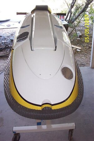

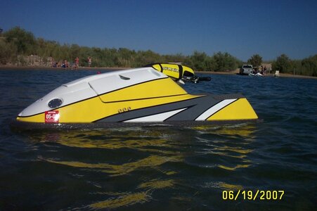

Filling it is a FS mod so you dont get hung up on it spinning around on the hood/nose or climbing up on the nose from the water...... If you dont do any of these tricks then you dont need it unless you like the looks........... I personally like it done for both reasons.
X2
I didnt feel like glassing the hole closed so I just had the local machine shop cut me a round piece of 1/8" aluminum($12) and I wet sanded and polished it up and used side rail Yamaha sitdown starhead SS screws. I think it looks like those polished fuel door/cap assy. peeps put on there cars and trucks. I like it and its somethting different anyways..

superjet-113 thats a good idea.. looks pretty sweet too. if i do myn it will have to bo gold platted fo sho... but really thats a good idea....
Thanks, I like it too and you just use the rubber seal from the filler for the template for drilling and of course sealing it between to the hull..
